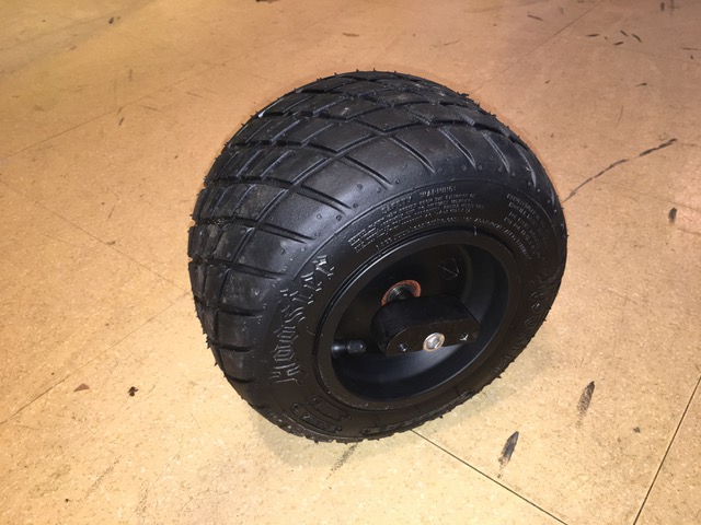

      @lia Amazing project! If it was a real rubber tire, what size would that be?
        Lia GT XR Pint Plus V1 DIY @Lemur last edited by
        @lemur Thanks :)
        It'd be a daft size. 5.75 x 3.25 - 3
        Currently it's made of 2 TPU halves heat welded together at the middle so it's actually not bad at deforming under load.
        I did want to add the decals but TPU is notoriously bad with retraction so I figured it'd leave that for the second attempt whenever I don't need the printer for 2 days.

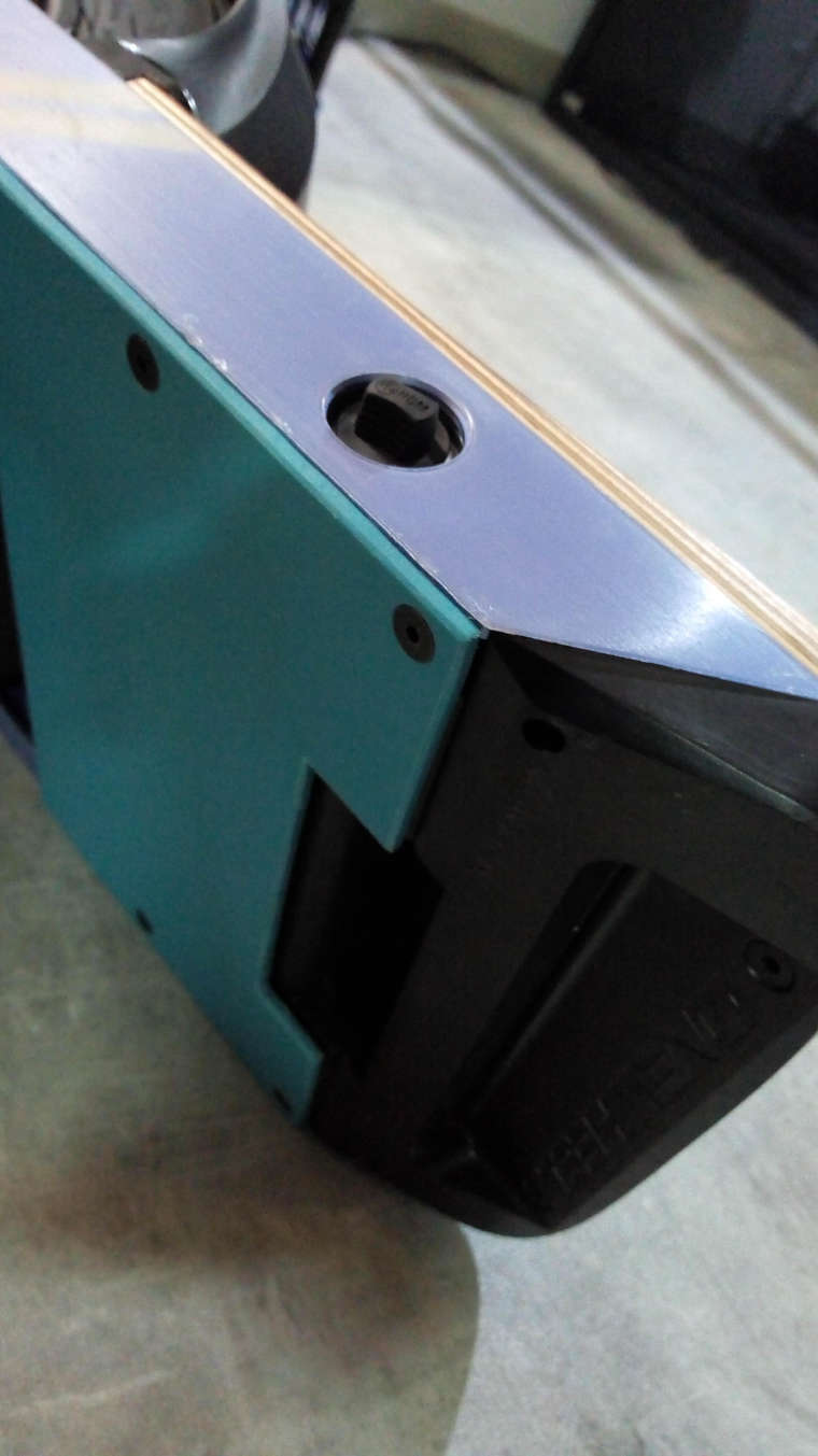

                      Just before sumbitting this a parcel arrived.... the power button I ordered like... 2 months ago showed up!!!
                      Needs a bit of modifying but it mostly fits and if you don't look at it too long it looks like the stock one. And yes... it does have a blue led in it to illuminate the ring around the button ;)

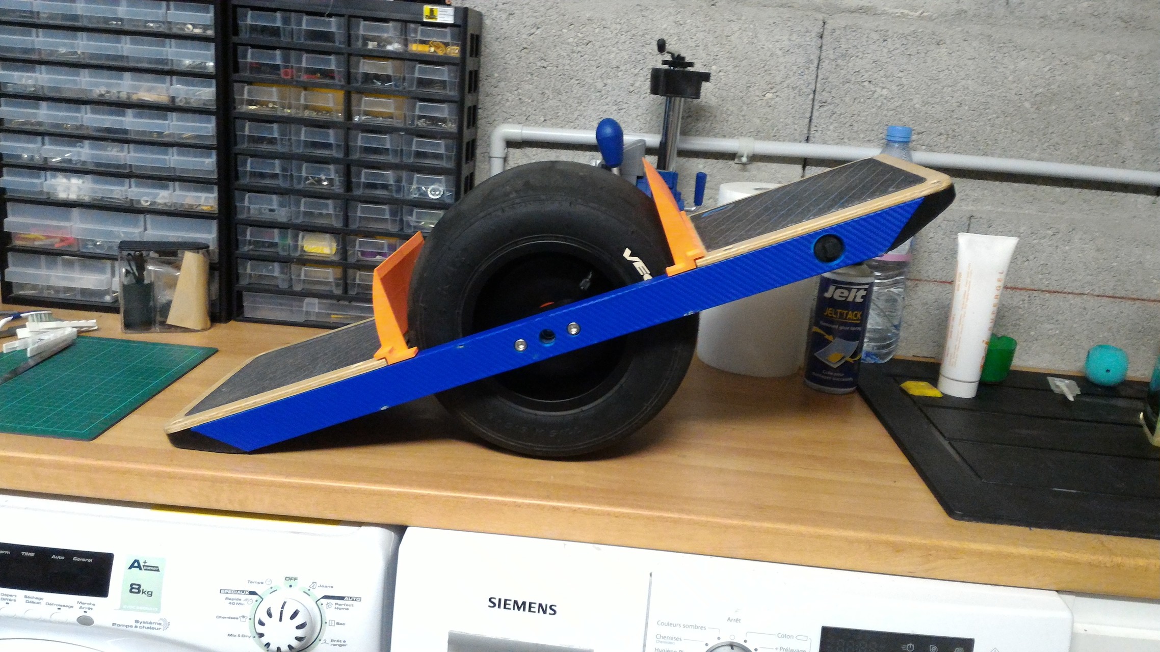

                      Did the right axle bracket minus the cutout for the keyed U channel because that needs the scroll saw which another jig was waiting to be printed.
                      As of now it's getting there. Made some cell spacers and taped the cells together ready for welding at some point later.
                        I tamed my scrollsaw and managed to cut the tiny U slot in the axle bracket then made minor corrections with some tiny jewellers files. Very very snug, I was concerned I would need to braze these together making dissasembly a bit of a puzzle however it's so snug that there is no play.
                        Managed to cut the lid of the controller and drill the holes out, genuinely happy with how it's beginning to look.

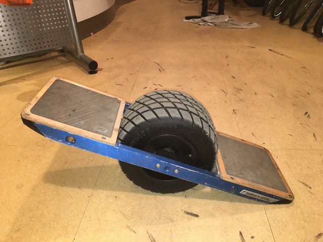

                            Correct, it's a 74mm 200w Esk8 motor what originally had a PU cover on it for the wheel. Here's an old pic of it before I encased it fully inside the hub shell.
                              On reddit I've had a few people genuinely think the XS will be something they could use properly. I admire their optimism and praise of my work but I don't think they realise just how small half scale is.

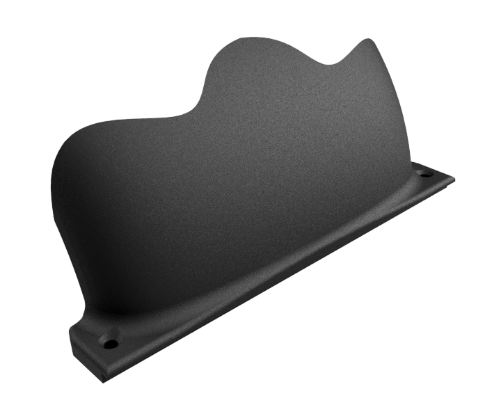

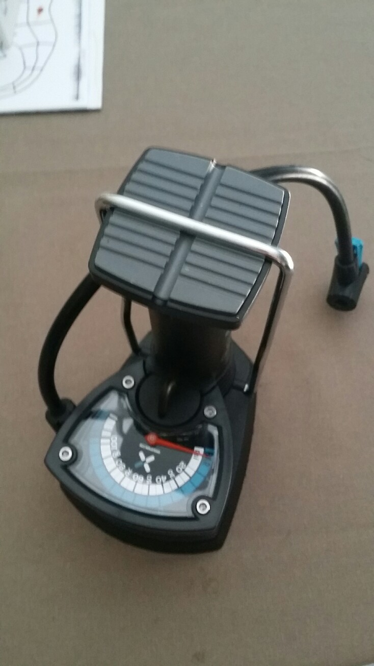

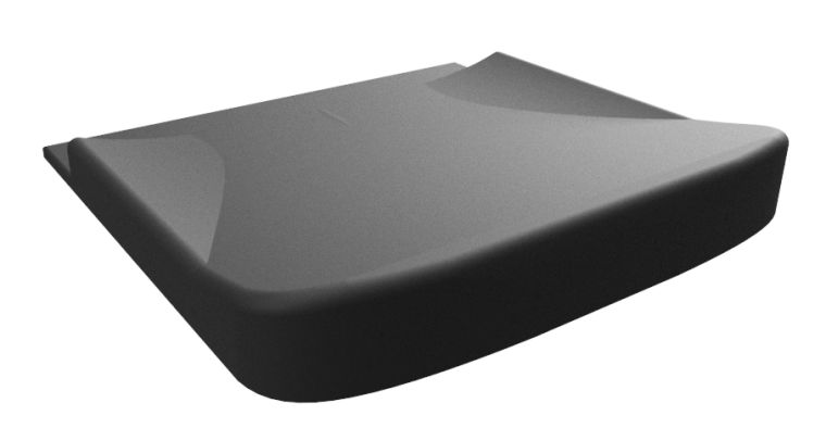

                                Also had the desire to make the charger so spent a few hours making a replica of that in Sketchup~
                                Will use a USB C interface in place of the normal C8 (figure 8) mains connector. Printed the top half and it came out okay.
                                Also you can see I re-did the battery housing and rear bumpers in 0.1mm layer heights which makes a huge difference to the surface finish and detail retention. Also printing the bumpers upside-down helps a lot with making the "Onewheel" wording show up albeit hard to see through camera.
