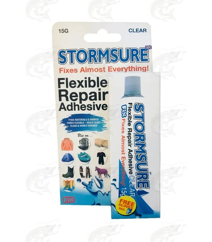

              2.) Single component polyurethane ('hobbyists'-)glue (with toxic solvents) as an adhesive for your slick-hard A75 polyurethane form against SBR rubber.
              Look towards Stormsure. Or AquaSure; AquaSeal.
              If you are new to this stuff - you'll be stoked *cough-cough .. amazed of how many different materials with various characteristics these can bond!

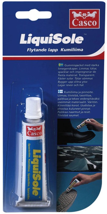

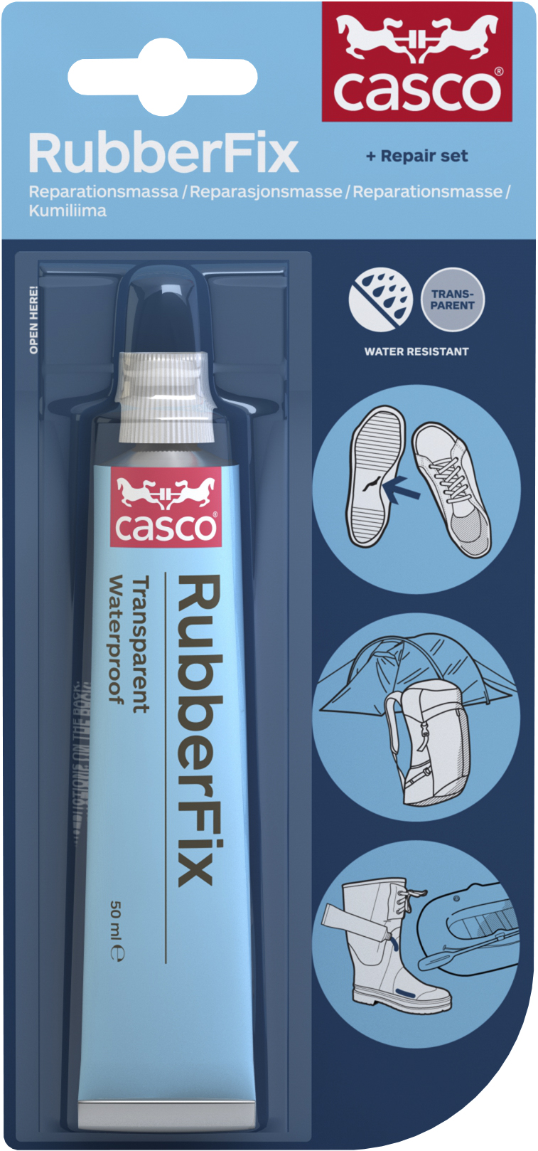

              (!) AVOID using Casco RubberFix (which is their recent equivalent for former superb product called LiquiSole) - they decised to go eco-firendly by removing toxic additives. Assuming the enthusiasts and DIY-ers are not responsible enough with glue leftovers and wastages.
