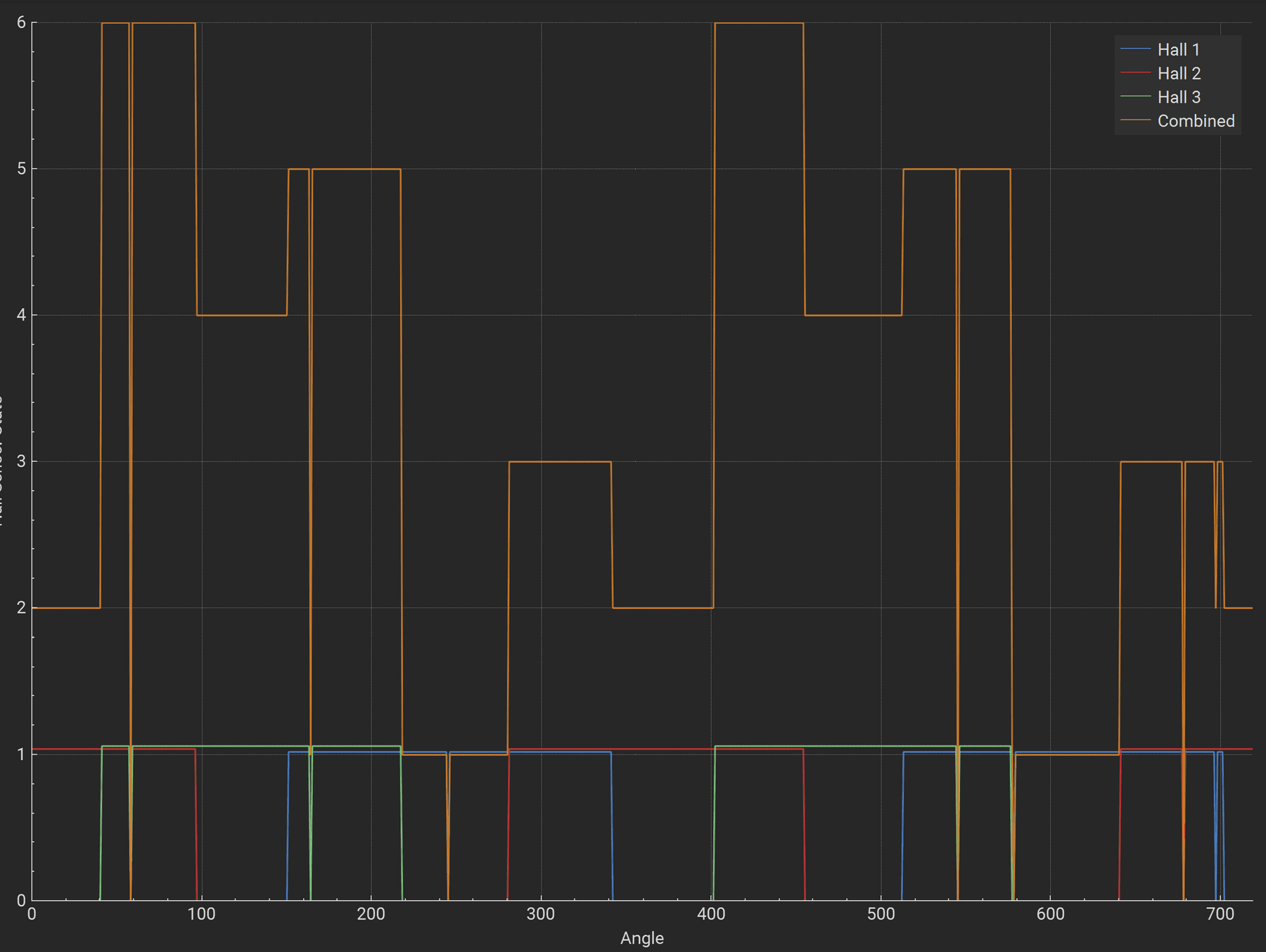

      VESC Tool has a command in the terminal called hall_analyze, which lets you.. analyze the halls? Idk, it's VESC Tool. It's both the best and worst thing to exist. It's supposed to be used to troubleshoot your motor halls. You're supposed to get nice, clean square-wave output, with nothing weird or fishy about it.
      Above is my hall sensor. It's not clean, and it looks a little suspect. Those strange, sharp dips could be either Vesc tool absolutely crapping its brains out, my halls in the motor screwing up, or a mix of both. I already tried this with both my MK8 and Ubox, got similar results on both. Could be the motor, could be VESC tool. I hate this damn hobby-
      So, where are we at right now?
      Well, I have four new hall sensors coming in, because one of the hall sensors DEFINITELY has damage to them, and it'd probably be a good idea. I've ordered a replacement MK8 with 120V MOSFETTS, and I'm currently trying not to go insane.

                Thinking back on the Hall sensor swap and VESC Tools Hall Analysis tool, I think I may have a reason as to why hall analysis was showing very wacky hall readings. It could be due to the fact that BLE isn't stable and may cause data to be intermitently dropped, leading to data being lost during trasmission. Could be the Vesc software itself on my iPad or computer being generally pretty jank and having some issues that cannot be diagnosed. It could be the VESC itself is old and is just showing it's age. Yes, I'm blaming my tools for a problem I can't solve, but it's the only thing I could think of outside of user error.

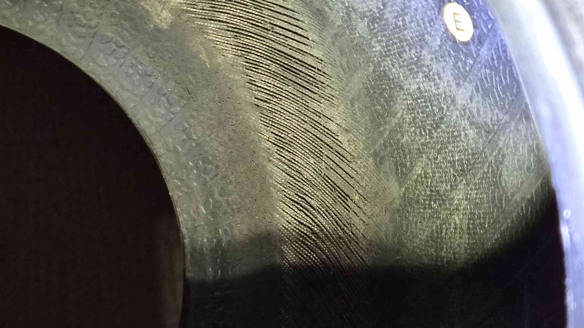

                        New tire too. The Thundercat didn't last as long as the previous tires, the sidewall probably gave out around mid-feb, lasting about 7-ish months before it would loose air. By the time I decided i was done re-airing the tire every few days, it was mid-june and the tire would go flat over the course of a 90 minute lecture.

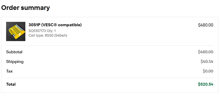

                        I decided after talking with some engineering buddies I know and people who can handle money better than I can that spending more money now on a much better setup is worth it in the long term.
                        I am going to have to get a 150V Ennoid. I was told to contact Ennoid about seeing what can be done about my 120V, but apparently he's on vacation until next week, so I'll have to wait.
                        30S1P on RS50 should give me similar range as my ME4T pack, but an exponentially more amount of the pucker factor in terms of raw power.
                        I'm still in shock that I'm even ORDERING a 30s1p pack, let alone going to install one.

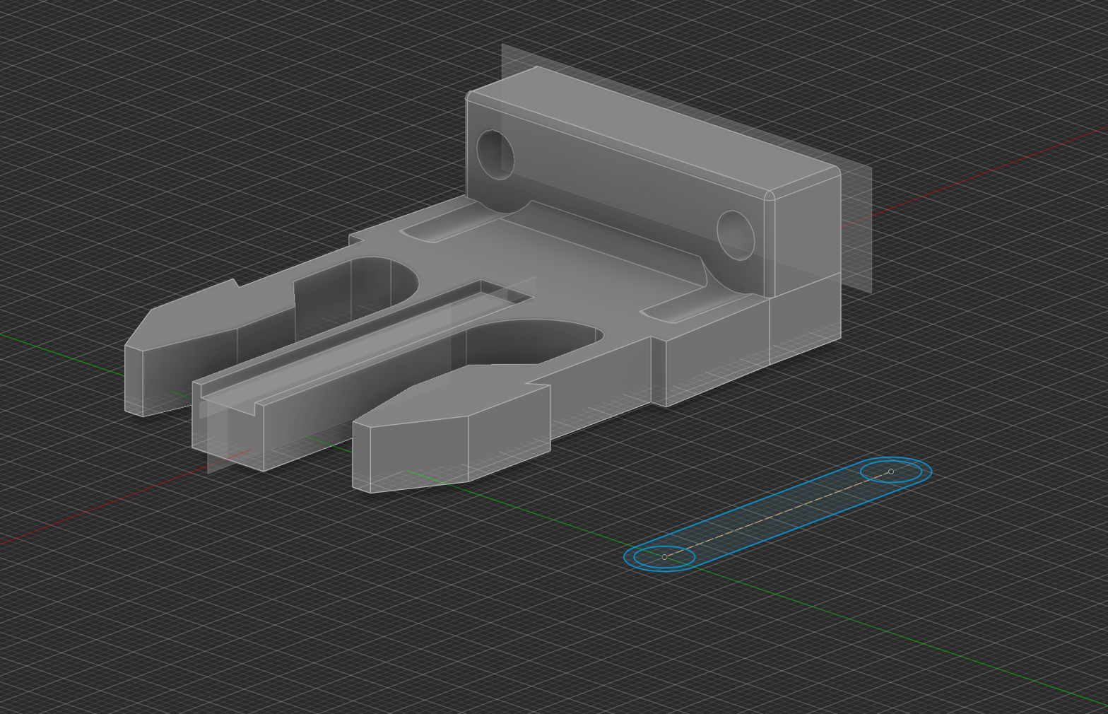

                        Using the quickies from OneWheelParts, I'm designing a clip that bolts onto the unused holes so I can carry around the board like a duffel bag. Supposed to be a one day print, but my printer (Now a heavily modified SV08 which could honestly have it's own form post) is tempermental about ASA.
                        If I get it done tonight or tomorrow, I will share pictures
