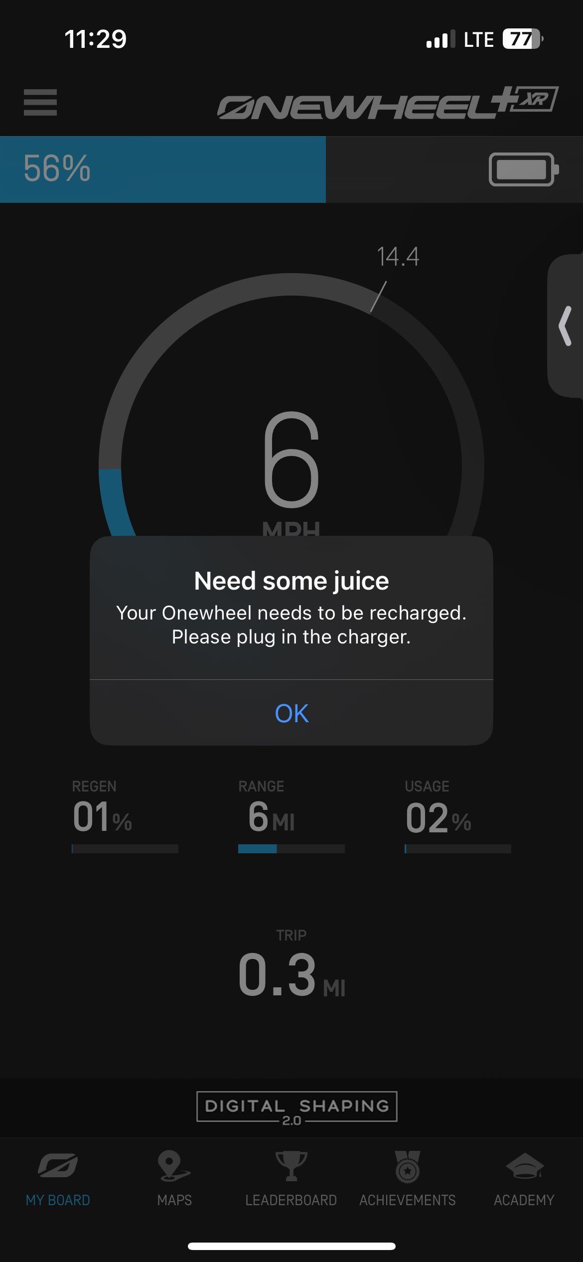

      Hello, I've been having some issues with my XR+. I've ruled out it being a battery problem with checking cell voltages and trying a new battery. It rides fine until at some seemingly random time it reports low battery and shuts off. Upon inspection of the BMS that I replaced last week to get it running I noticed this.

                @lia Update: It is indeed NOT fixed. After 2 half charges, the symptoms returned. I have noticed that it happens when going uphill. Going to do some testing on the BMS and see if I can track down any faulty parts.
