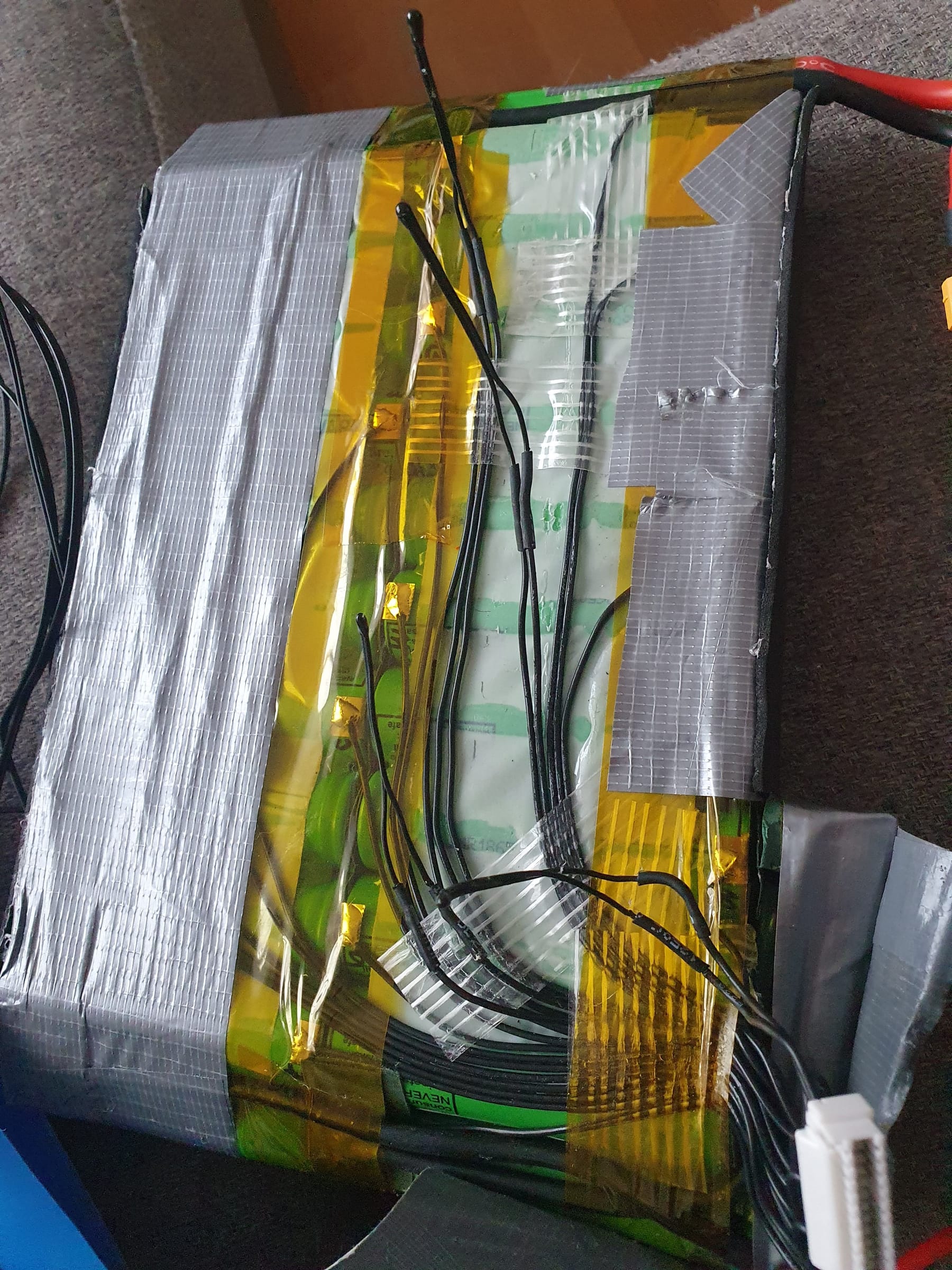

            I have a CBXR which is exhibiting identical symptoms. Outside temperatures around 6 C or lower and the board starts throwing error 17, even though diagnostics show battery temp around 15-17 C.
            I have measured the resistance of the thermistors and they seemed fine-ish (between 10.2 and 10.3 kOhm at room temperature), but I went ahead and installed a new set of thermistors anyway. I have yet to test it out as the glue is still drying.
            Here they are visible after plucking them out of the pack. It was strange to find them just hanging there, without actually being attached to anything, and covered by a thin layer of tape. I've decided to glue them to the cells to get a more accurate reading.
            But I am still hesitant that this will fix the issue.
            Is there a known problem with the BMS where its internal resistance becomes too high with cold weather that it triggers the fault itself, even with working thermistors?
            Anything else I could check?
            The board is a 4209 without a chip. Battery is around 4 years old and I am a new owner. Previous owner said he has never ridden in weather colder than 15 C ambient...
            Thanks for any input!
              Lia GT XR Pint Plus V1 DIY @martinlink last edited by
              @martinlink Personally not aware of known temp issues with the XR platform. Do you have any high res pics of the bms just in case I can spot anything that looks a bit off?
              Being 4209 there's quite a lot of options if it is the BMS that's faulty. Hoping your thermistor swap worked but if it is the BMS there's probably a good few people in a local ride group with a bunch just laying around since most swap them out when vescing and have no other use for them.
              For other checks I'd try probing between ground and each one of the thermistor pins on the BMS while it's disconnected from everything. All should return a similar reading to eachother. If you find one way out of line then that's where to start looking by tracing back that one pin to a component like a cap that may have gone bad or been knocked at some point.

                  Wellll, no dice... New thermistors in, board on the balcony for a few hours at +6 C and almost immediately triggered the same fault. Battery temp at that moment +11 C.
                  If anyone has some more pointers or measurements to take to narrow it down, please let me know. I'll be disassembling it again today or tomorrow :(
                  Also, any working BMS on offer?
                  Thanks!
