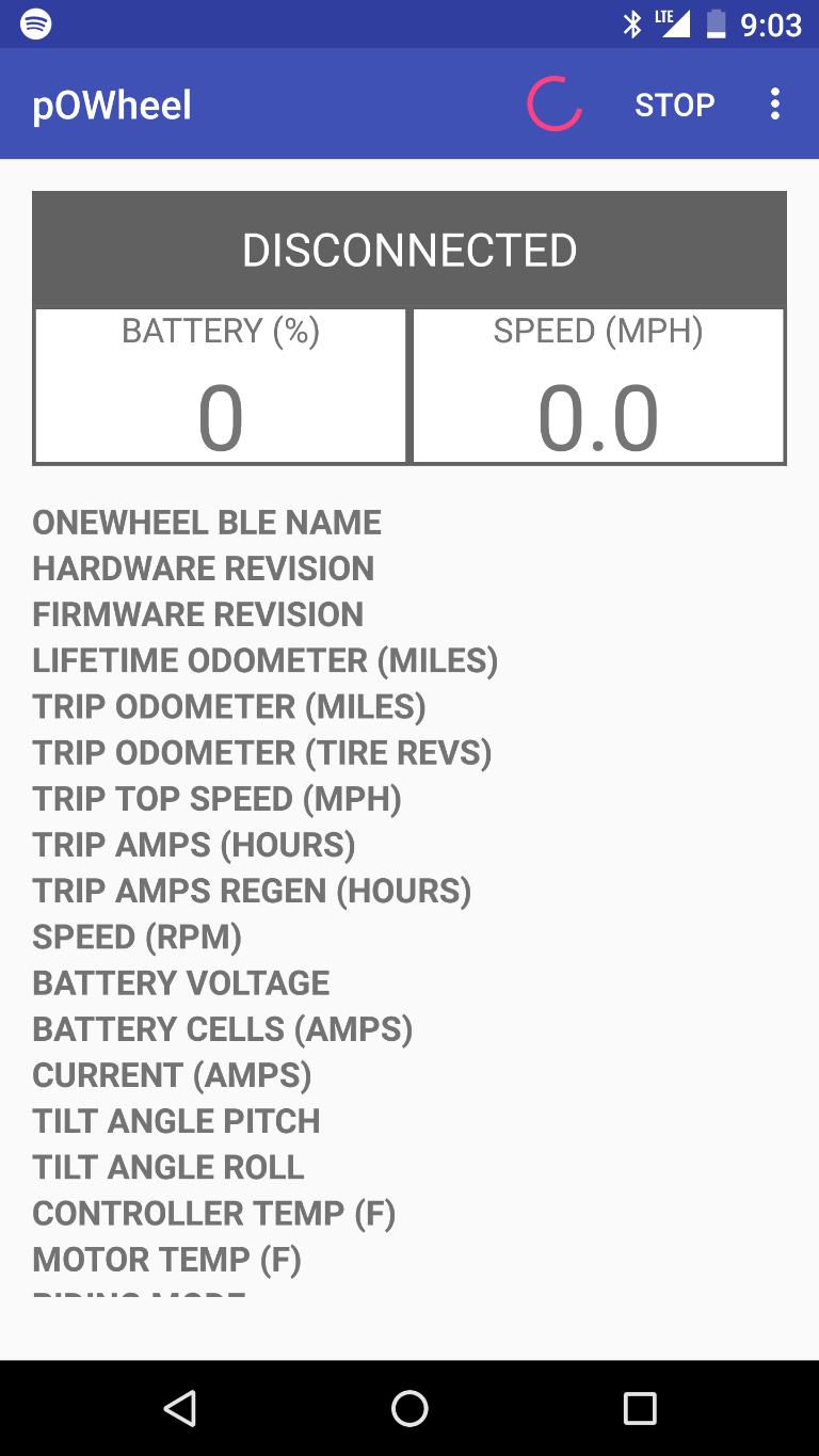

      I believe one of the bottle necks on the Gt is the motor and bms current limits.IMG_7395[1].PNG

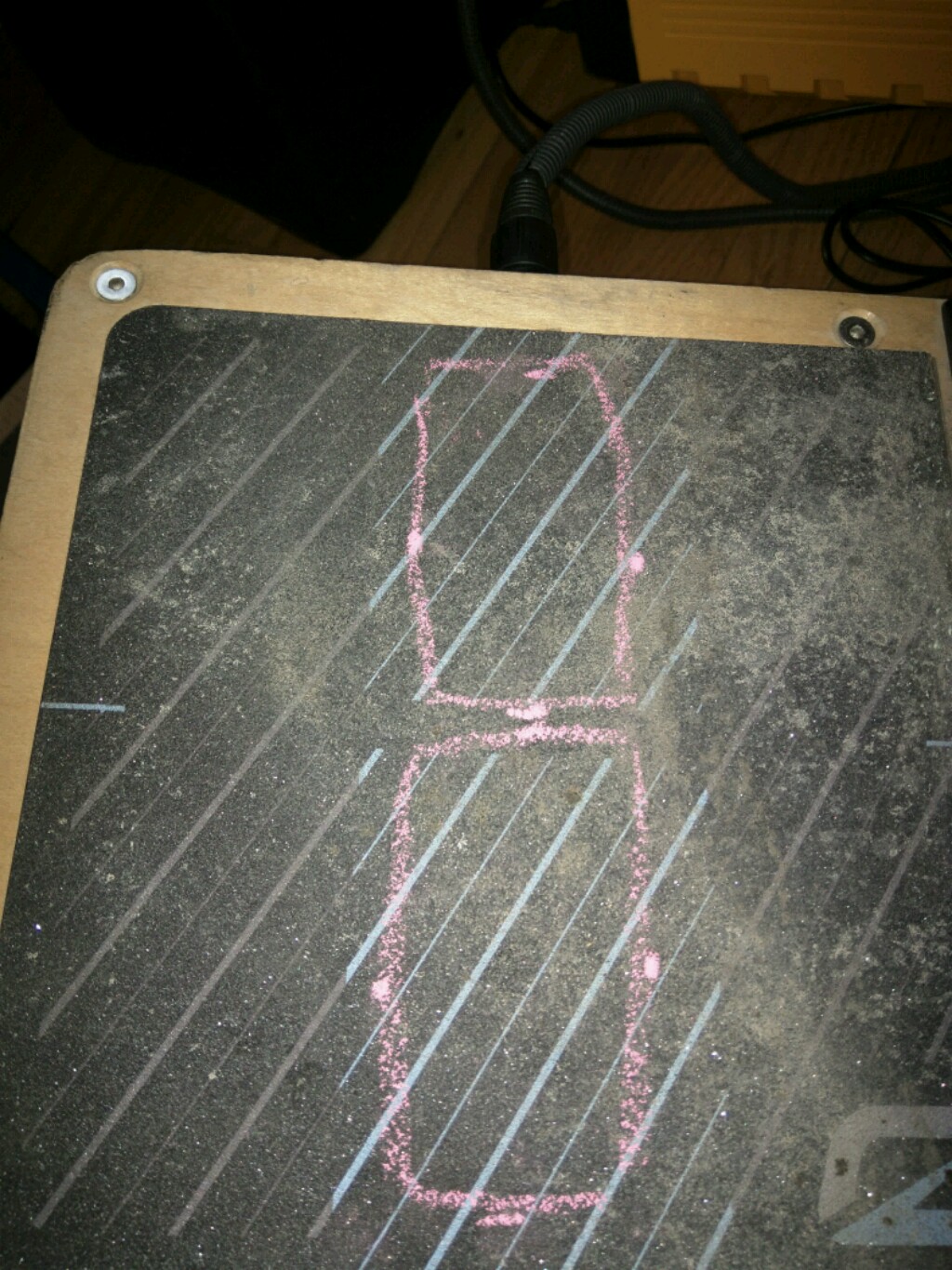

        @lemur Superflux/Gt works, I went for a ride and the Sf/Gt hybrid and it accelerates like a rocket and super quiet.
