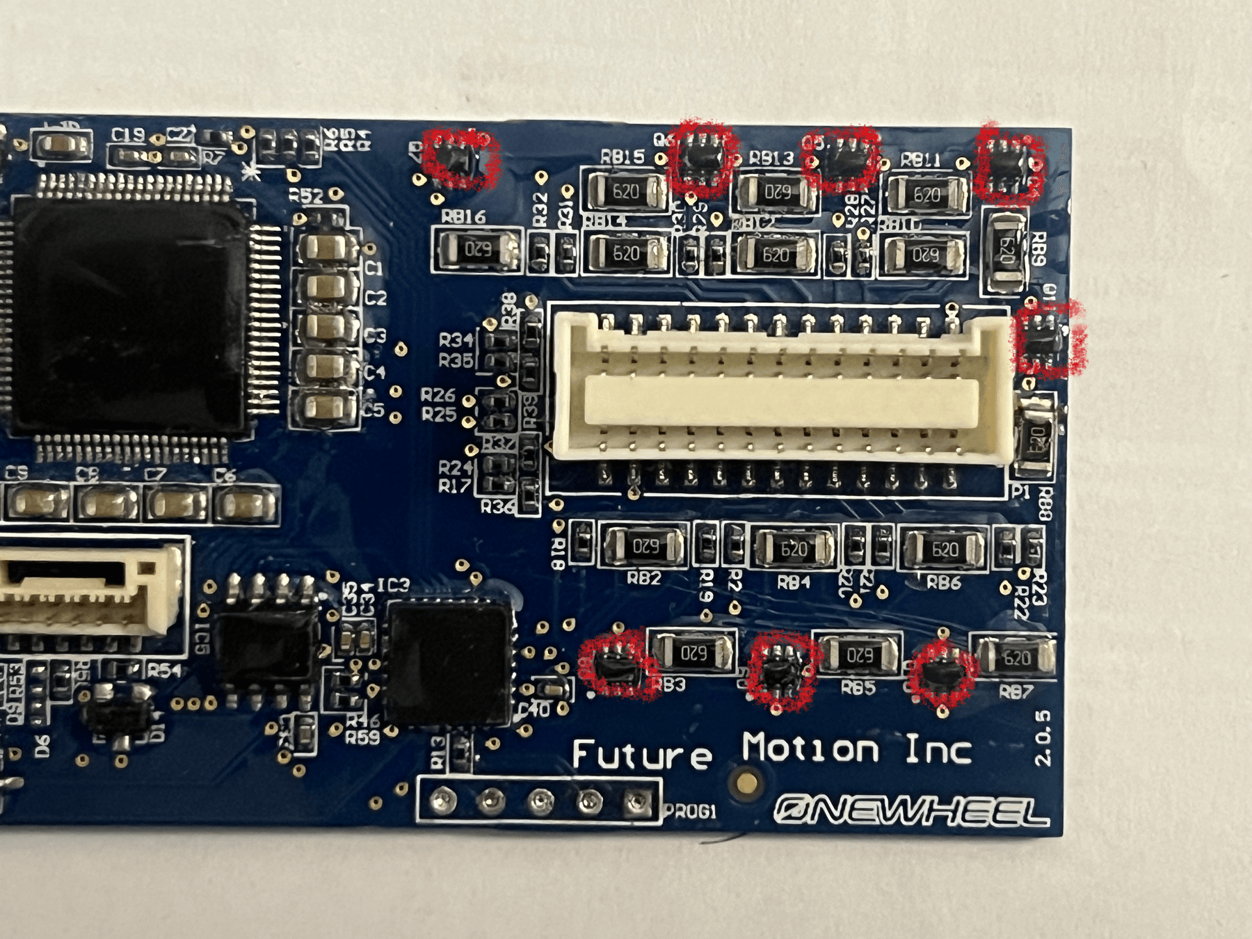

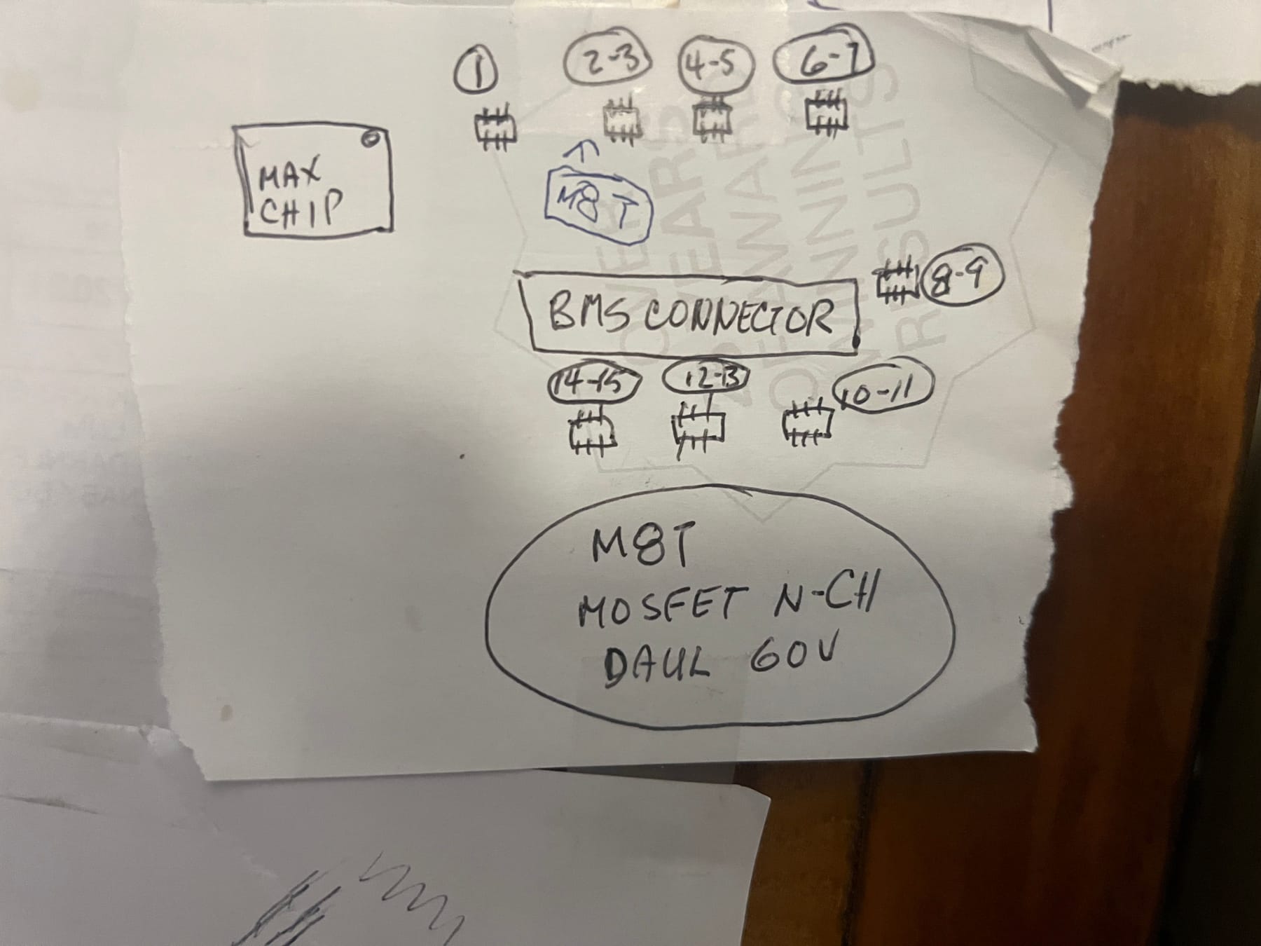

            @ikaruspint Here are the little mosfets that affect cell balancing.IMG_0059.png IMG_0060.JPG

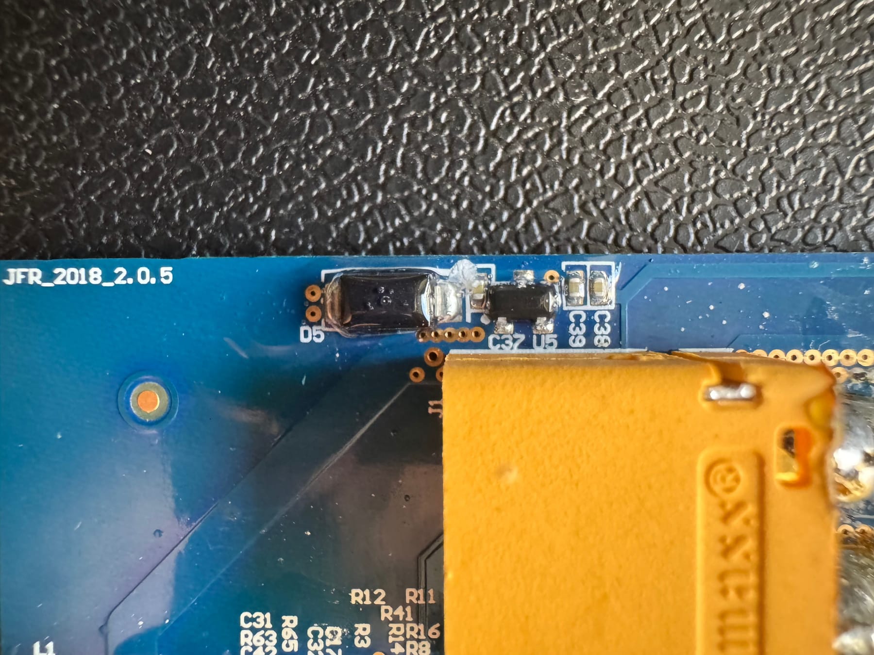

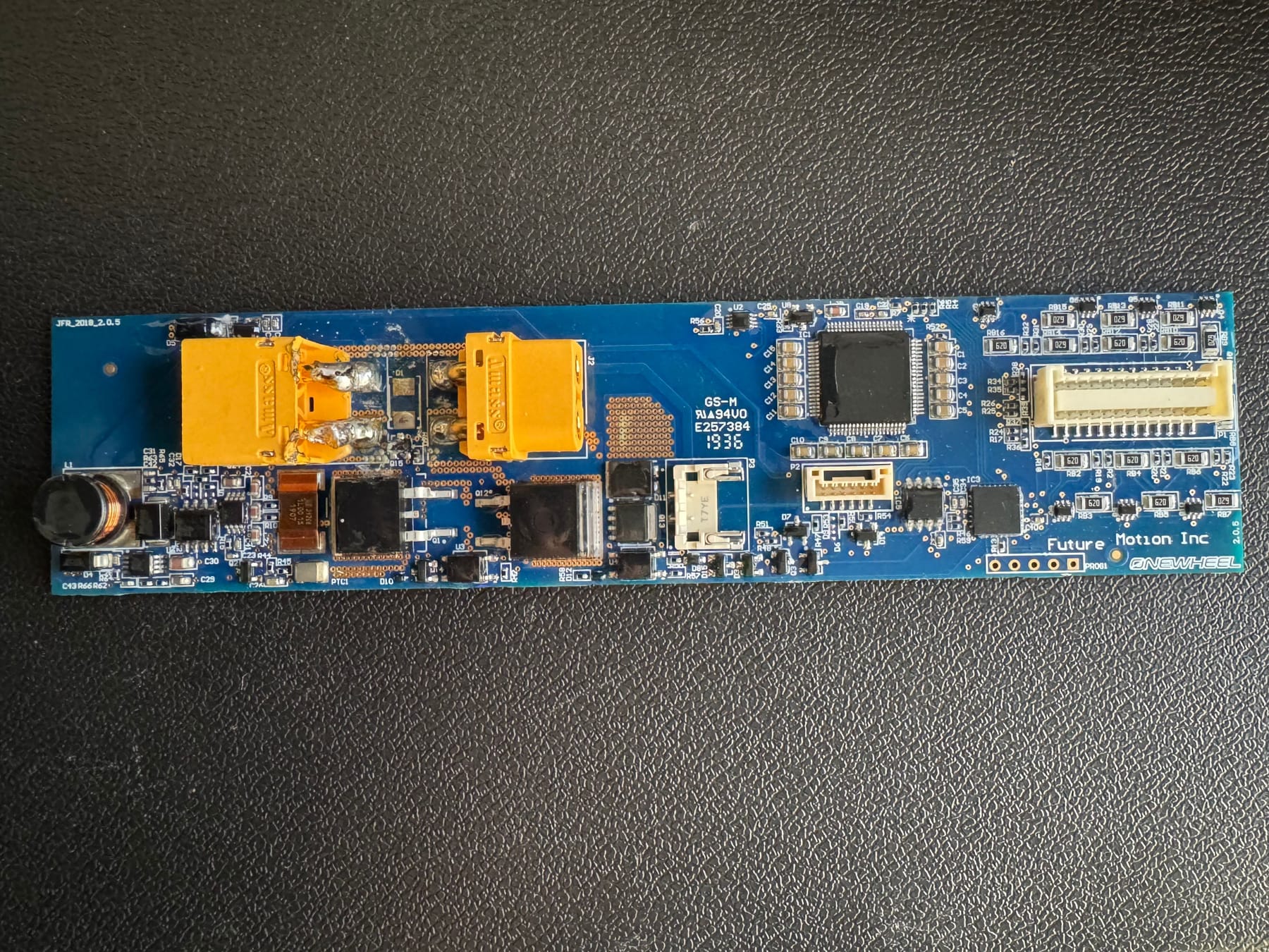

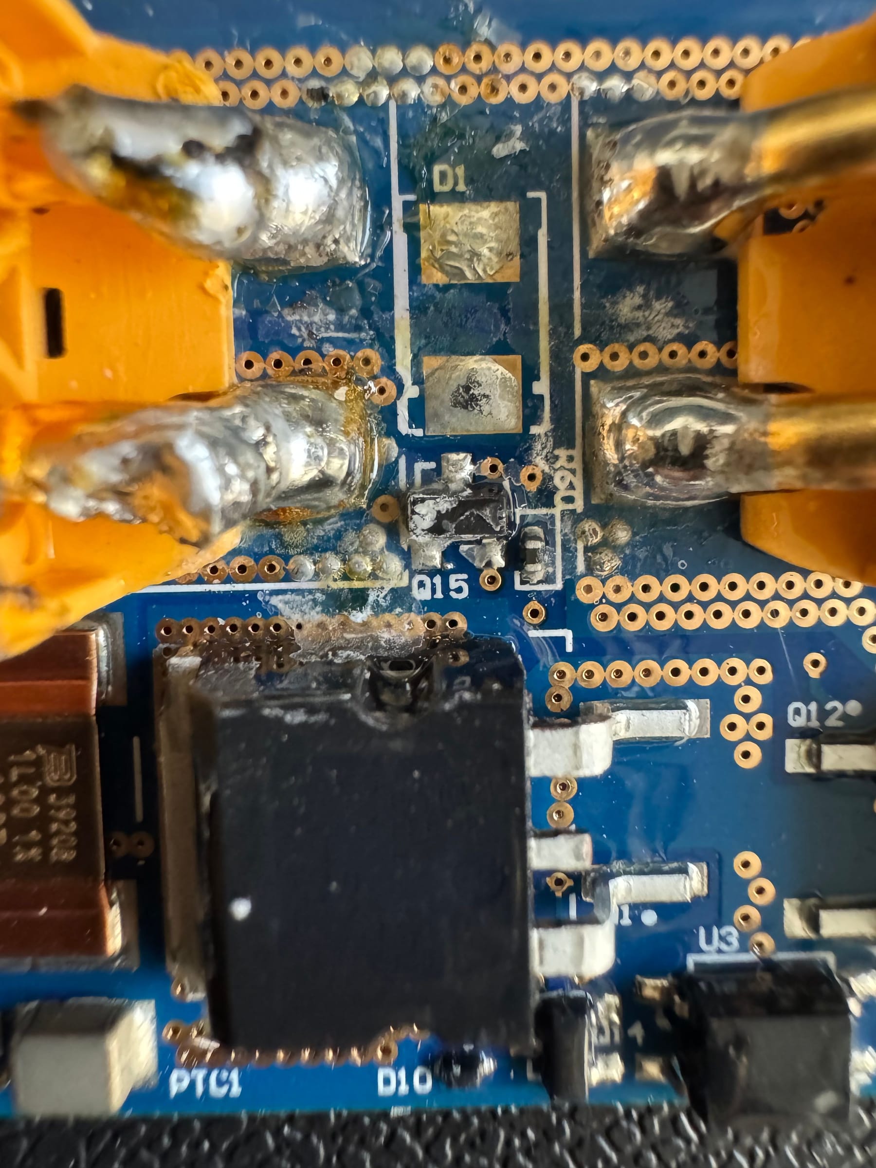

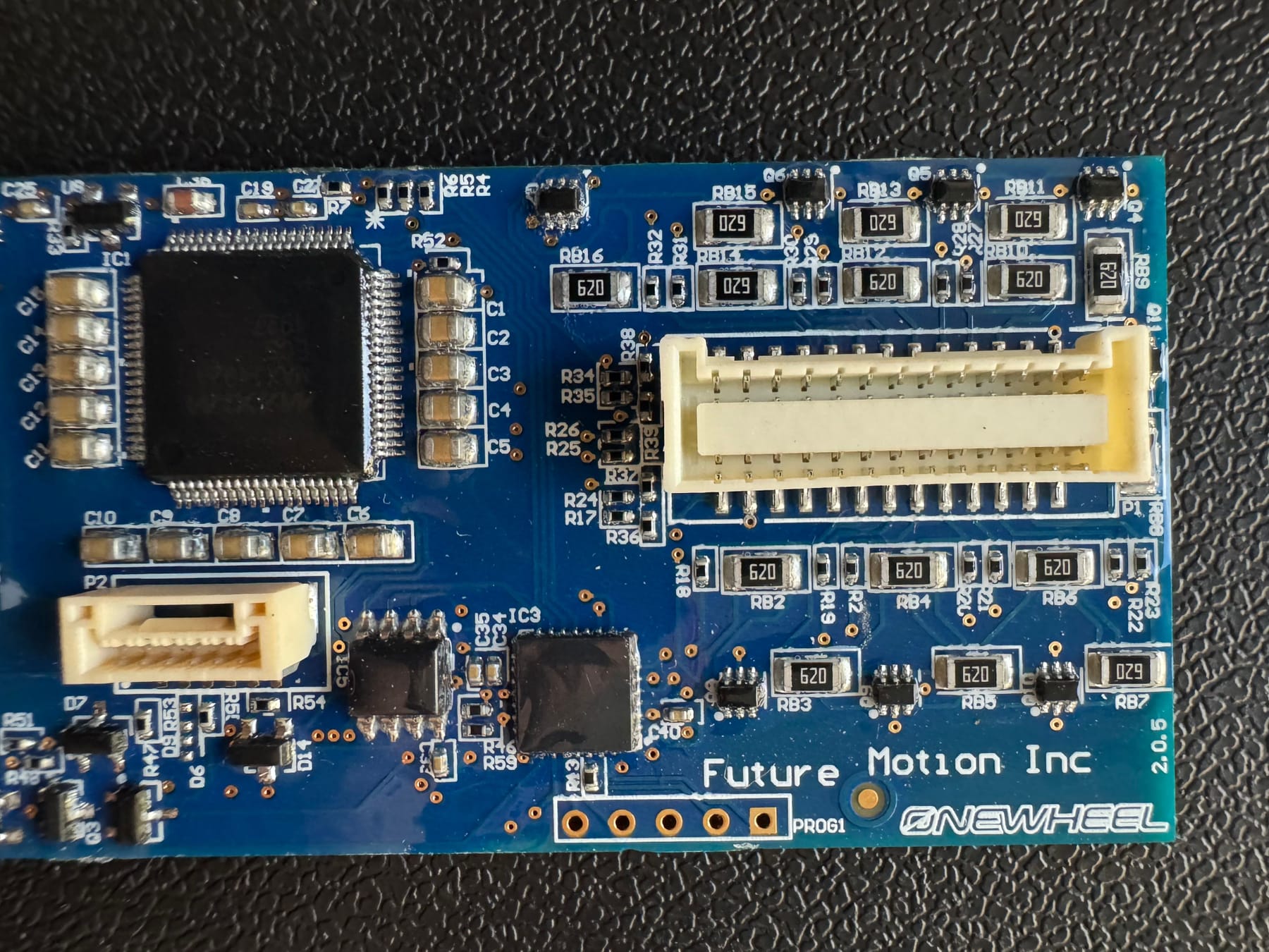

              Thanks for coming back to me @Lemur . Here are some pics of my BMS. I thought it looked pretty good, save the bit of solder on my XT60's from the VnR. I do however think I had an overheat at some point as some of the plastic coating over the xt60's show evidence of temperature. I think this was during use though and not from the soldering or charging (I was super careful when soldering onto the XT60 legs, but you never know). The component at q15 looks like it may have gotten some heat? Also d5/c37.
              How do you remove the clear coating from the PCB to access the components underneath. I have never worked on such small components as this before, do you use a solder rework station?

                Lemur @ikaruspint last edited by
                @ikaruspint The conformal coating is soft and is easily removed with a toothpick, not use metal tools.
                The discolored coating is normal as the conformal coating goes cloudy under heat especially at the Xt60 solder points.
                Use a heat station for smd component removal, the solder on most factory circuit boards is non lead and reqiues more heat than leades solder.
