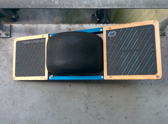

      Since the XR suspension builds have proven bulletproof for up to 27s for the last couple of years, it's time to build one to fit the Pint.
      It's just a start of the build but I'm confident that this will work, this design is based on the XR design, but scaled down with smaller com ponents.
      I have Lia's PX battery box that has been used in another build.
