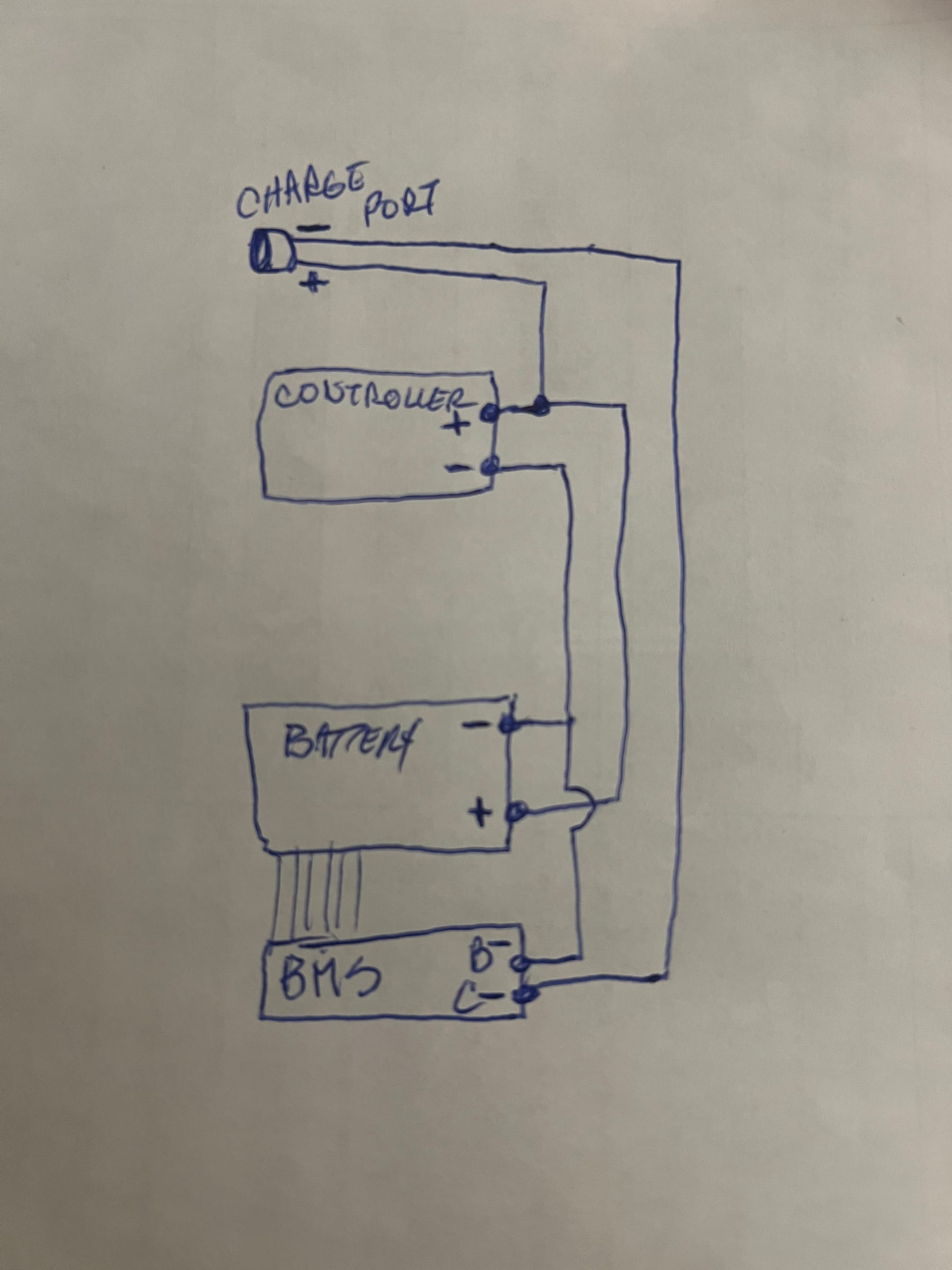

          Lemur @syanelli last edited by
          @syanelli Here's a simple crude diagram, but basically I eliminated the positive charge wire as it is tied into the controller positive from the charge port.

            syanelli @Lemur last edited by
            @lemur does the 3-10a when charging not affect the controller?
            L 1 Reply Last reply Reply Quote 0
              @syanelli Charging does not do anything to the controller as the charge negative goes to the bms.
